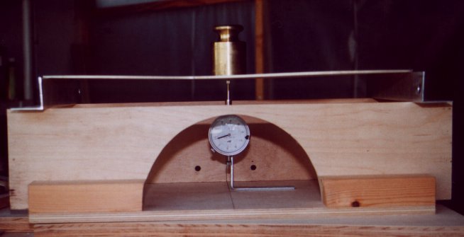

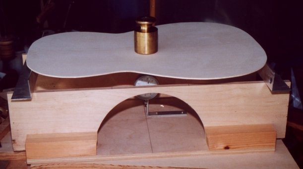

[QUOTE=James Orr] Couldn't something similar in concept be put together to measure stiffness as long as the tops were of the same width and length? [/QUOTE]
I don't think you even need to have the tops be the same length. As long as the supports on both ends are consistently spaced, say 18 inches, it wouldn't matter how long the top was. Here's a pic with a 1kg weight testing deflection. We could really get a lot of good data if everybody would do this. If the OLF created a database of deflection testing to some standardized specs, it would be invaluable. It only takes about 15 minutes to build a rig like this, and about 10 seconds to measure a top.
